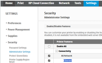

I have figured it out.
It's because of the disabled Ethernet feature which has nothing to do with WIFI but looks like there is some kind of software issue.

What disabled ethernet feature are you referring to? Are you saying to disable Ethernet all together, even though its not in use? I guess I am asking for more clarification on what steps you performed with your specific printer.
It's in the printer's Embedded Web Server -> Settings -> Security -> Administrator Settings -> Connectivity -> Ethernet.
When it's disabled I have the mentioned issue. Keep in mind you have to restart the printer in order some of the listed features to take effect.
