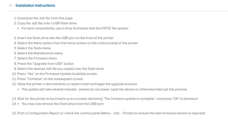

So, I have been trying for a few days now to update the firmware on this printer. I have tried through the printer webpage, on the printer console itself and the Printer Update Utility.  It's a no go on all three options.
I see I can download the firmware file but how do it get it installed on the printer?

Download the firmware BDL file here https://ftp.hp.com/pub/softlib/software13/FW_Commercial/4301_4303/HP_Color_LaserJet_Pro_MFP_4301-430...
Copy the file to a us Fat32 formatted USB stick and then follow instructions below:

Thank you soooo much!  That worked!
