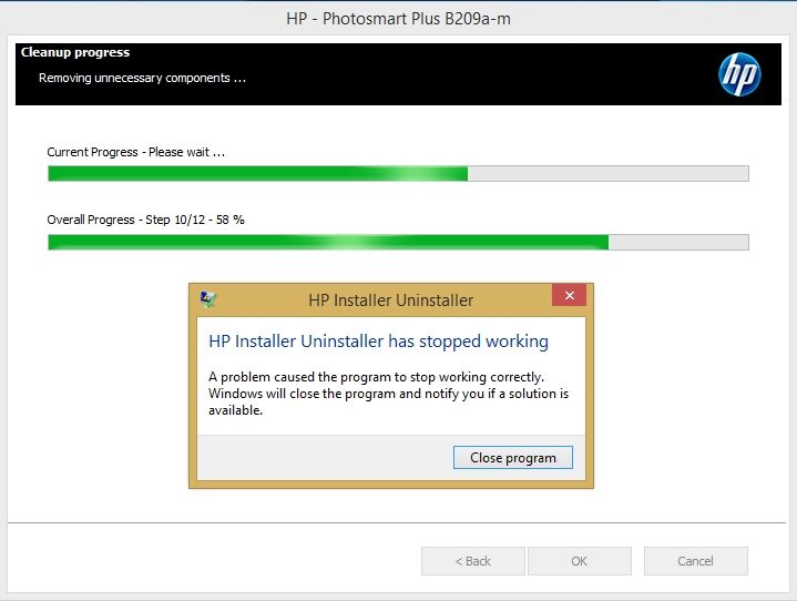

Thank you very much for your  reply. I tried to complete the steps as suggested by you till the uninstallation of the product. While uninstalling it, I got an error. Please find below the screen shot of that error.

As you mentioned when you uninstall the software you are getting error HP uninstaller installer has stopped working,
To resolve the issue, click Close program, click Finish in the You must restart your computer to finish the uninstall window, and then restart the computer to complete the software removal.
Refer this article to know more information about the error.
If the issue still persists uninstall the software using Revo uninstaller. You can search for the software in google and install the software.
