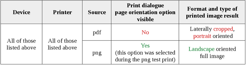

PDF and PNG investigation
The print source example pdf map was downloaded to a Linux PC and the map exported to a png image using GIMP. Both the original pdf and the png image were transferred to SD card and then printed from each of the above listed Chrome devices to each of the above listed printers using HP Print for Chrome. The available print dialogue options and the final results are summarized in the following table:
Every landscape format page in every pdf document I have examined, has done the same thing.
