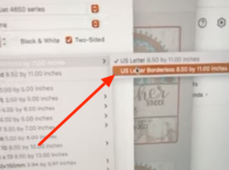

Simple question: The published specs for the Smart Tank 6000 says it can print borderless up to 8.5 x 11 inches. I can't seem to do this. Any advice as to how would be greatly appreciated.

Ok, then check the Paper Size is setup to "Borderless - Letter 8.50 by 11"
and then click Print button.

Thank you for your quick reply, but you haven't understood my question. The specifications  state borderless printing up to 8.5 x 11 inches, which is the size I want to print and cannot do. Smaller sizes are not a problem.
Hi @MelZel
https://www.youtube.com/watch?v=XsIBYRHgslA&ab_channel=MelindaMiller

Again, thank you for the reply. We are getting somewhere as in following the method in the video, I now have no border left and right but an almost 1/4 inch border top and a 1/8 inch border bottom. I've checked and my paper is 8.8 x 11.00 inches. Any further ideas? And again, thanks.
SOLVED!! Thank you for pointing me in the right direction. In addition to the "Borderless" menu selection, you have to choose "Fill" from a second choice available on the screen. Result is a perfect borderless print. The GUI could be better, but the solution was there.
