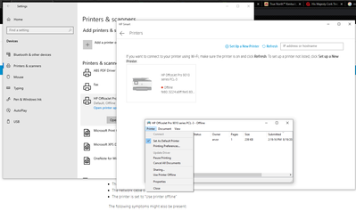

My printer and computer were working together just fine. All of the sudden, only the scan worked through HP Smart but the computer printing function said the printer was "offline" and would not print. I went through the 10 steps on this page:
https://support.hp.com/lv-en/document/c05087973#Install_current_software
After the re-install printer and HP smart process the situation has gotten worse. Now, HP Smart and my computer do not recognize the printer. I have tried re-starting everything multiple times and have updated windows, hp smart, and the printer driver.
The printer settings are not the issue. The printer scans and prints just fine from my wife,s computer via wi-fi. It is a problem only on my computer.
Thank you for your help!

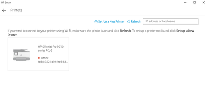

Here is a screenshot of the error I am getting now in HP Smart when trying to add the new printer.

@loonrider, Welcome to the HP Support Community! I’m here to help.
I understand you are not able to print.
Run HP Print and Scan Doctor to diagnose and fix any driver issue
Click here to download the file. Once downloaded, make sure to run the file to start the installation and click on 'Fix printing'.
If the issue persists, proceed to the next step.
Install the printer using the TCP/IP port:
Check for any pending Windows updates first.
- On the PC, go to Control panel > Devices and printers > Remove the existing printer entry > click on Add a printer(at the top)
- Under 'Choose a device or printer', click on 'The printer I want isn't listed'.
- Select 'Add a printer using a TCP/IP address'
- Find the IP address of the printer by tapping on the wireless/ethernet icon on the printer screen
- Type in the 'IP address in Hostname or IP address box, click next
- Proceed to the next steps by following the on-screen instructions.
- Try printing. (Do not use the HP Smart app. Open the File > Click on Print)
