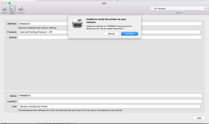

Thought I was getting somewhere - it WAS my Mac pw, thanks for that. Now software is installed and I get this. And I hate to sound like an idiot but what is the WPS button ;/Screen Shot 2020-01-07 at 4.31.41 PM.png

@STstace, thank you for the information.
It seems like the driver in the disk is not compatible with this version of macOS. Before installing the printer on the MAC, let us connect the printer and the MAC wirelessly.
