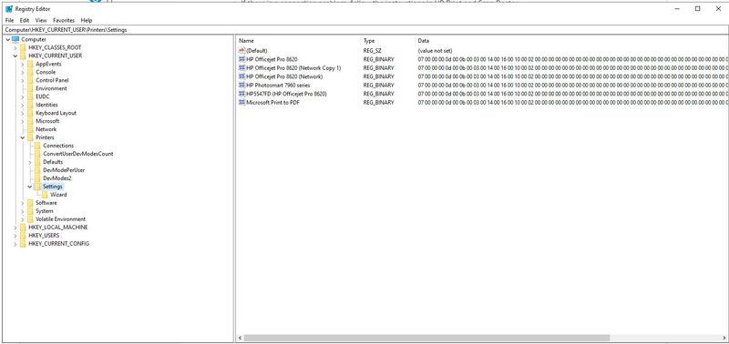

I took a couple of shots in the registry that I thought might be helpful.  It looks like I have duplicate 8620 entries.
Please see attachments.

Yes, they are the multiple entries, remove them and complete the uninstallation process.
And then add the printer, try printing.
Keep me posted for further assistance.

I removed the duplicate entries from the registry, rebooted, and ran HPPSdr.exe.
It went as far as the step to select the default printer and the process wouldn't go beyond that step.
I also noted that the system functionality for other printing options like Microsoft print to PDF was no longer working properly so I thought that I might have messed up the registry.
That prompted me to do a registry restore to get back to a known state.
Now HPPSdr.exe ran all the way through to the print test but it would only print to a file.
Then I tried the next section of your recommendation to add a port but the ports are all grayed-out except the print-to-file port.  So I can't change that.
Interesting is that the fax installation for the 8620 has all the ports selectable, but print-to-file is the only option on the regular printer installation of the 8620.
