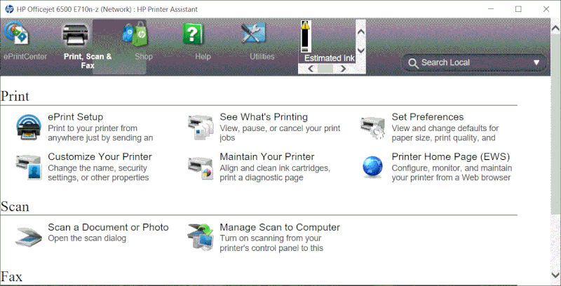

Both seem to work work fine with the "See what's printing" shortcuts, but the Printer Assistant
window has a problem displaying Estimated Ink Levels information.
On the Desktop, it properly shows:
But on the Laptop, it shows:
PrinterAssistantLaptop.GIFWhen launching the Printer Assistant on the Laptop, I get a script error:
An error has occurred in the script on this page.
Line: 155
Char: 17
Error: NotFoundError
Code: 0
URL: file:///C:/Program%20Files/HP/HP%20Officejet%206500%20E710n-z/Bin/HPSolutionsPortal.hta
If I continue running the script, the the Printer Assistant window does open and the HPSolutionsPortal.hta file IS in fact in C:\Program Files\HP\HP Officejet 6500 E710n-z\Bin,
but is apparently not being recognized.
Am I missing something to do with .hta file associations?
I have re-installed several times from the Laptop.
I've even run sfc /scannow - shows no integrity violations.
Any ideas on where to go from here?

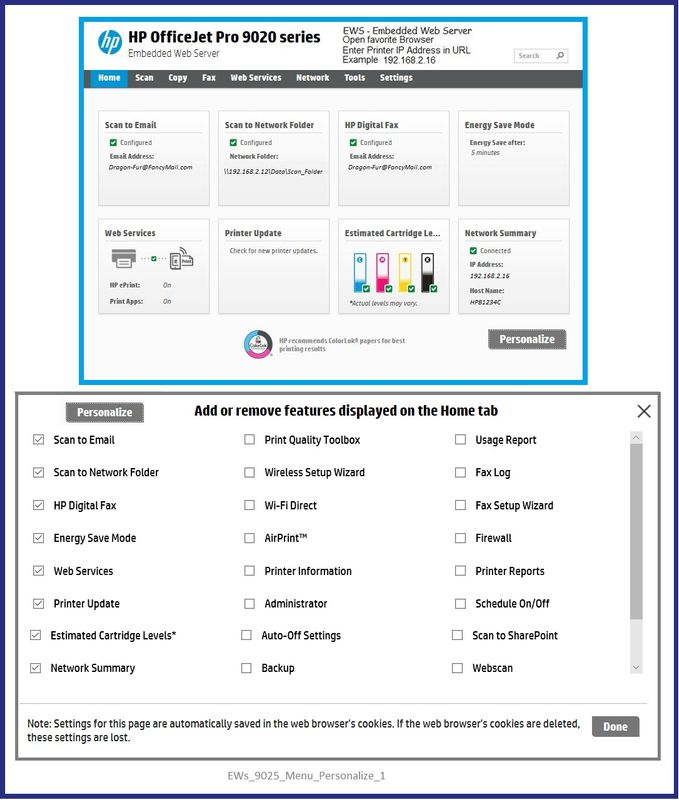

If your printer is on the network and you need to "talk to it",
Use the Embedded Web Server (EWS) to query the settings, check Ink, and make adjustments.
EWS > HP Document / How-to
Use the HP printer Embedded Web Server (EWS)
Open your Browser > Type / enter the Printer IP address into URL / Address bar
Example - EWS - Home Page
EWs_9025_Menu_Personalize_1EWs_9025_Menu_Personalize_1
and / or
Tab Tools > Supply Status
Optional (at bottom of webpage) > Print Printer Status Report
Example - EWS - Tools > Product Information > Supply Status
EWS_9025_Tools_Product_Information_Supply_Status_1EWS_9025_Tools_Product_Information_Supply_Status_1

I have uninstalled and removed printer software several  times.
Problem continues.
I have run a repair install of Windows 10 Pro 22H2
Problem continues
The same downloaded printer software file was used on both desktop and laptop.
The desktop has no script error - only the laptop has a problem.
The HPSolutionsPortal.hta file is in the proper directory but is reported as not found.
That leads me to think there is some registry error with the .hta parameters.
Is there any way to check that?
Alternatively, is there some way to download a standalone version of Printer Assistant?
To be sure I haven't missed anything, can you point to your source for "Check_and_Remove_Section_4" ?
For what it's worth, EWS does display ink levels. I'd like to know why Printer Assistant doesn't.
I'm uncomfortable when something no longer works as advertised
