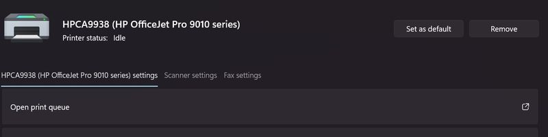

Hi, I had to reinstall Windows 11 which meant I also had to reinstall my HP 9015 via the Add Printer option. In Printers and Scanners I only see the printer, but in the dropdown (Word, Excel, Adobe, etc.) there's also an option for HP Fax and it ALWAYS defaults to that one first, even if I set the regular printer as default in Printers & Scanners. I went into Device Manager and uninstalled the Fax one but that ended up uninstalling everything so I needed to add the printer again.
How can I remove the fax option from the dropdown menu? I will never have a need for it here. Thanks.
How do I remove the fax option?
This is the only one that shows

02-15-2025 12:35 PM
OK.
Your image shows the Fax set as the Default Printing device.
Admittedly, if that is not true, and the default is actually the main driver and not the Fax, none of this makes sense.
Can you gain enough control over the "Fax" device to Remove it?
What else?
Some of this might be a result of the "Add Printer" method used to install the printer.
Not sure that "Add Printer" is going to install what you expect / need to control the Default Printer.
If you have not done so,
- Install the Full Driver printer software
- Reboot the computer and log in
- Make sure Windows is not controlling your Default printer
- Check / set the default as shown previously.

02-15-2025 12:18 PM
Hello, I appreciate your reply. Unfortunately, my printer is already set as the default yet when I click the dropdown in Word (for example) it still defaults to the HP fax option first. I then have to manually select the regular HP print option. I'm unsure why it's doing this.

02-15-2025 02:12 PM
Hi, thanks for the help. So what I did was I removed the printer, I kept HP Smart but I downloaded and installed just the HP driver software so I can still use HP Smart (I tested it with a scan and it worked), and when I went to print there is now only one print option (HP OfficeJet Pro 9010 series PCL-3 (network)). I guess I need to keep HP Smart as well as the older HP driver software on the computer for it to work. ?!?!?
I appreciate your help!
