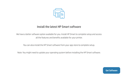

My installation attempts.
1-  Downloading Hp easy start from the hp website, because of I downloaded this app page of Hp Ink Tank 310 series.
 a) At the first step
b-) second step
 c-) after preparing the software, the following appears.
 d-) Clicked, get software and dowloaded the last UPDATED HP smart app.

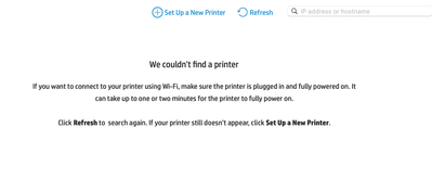

e-) add your first printer
f-)  the result of HP Smart App.
g- ) Clicked on the Set up new printer but there is no solution. After searching there is no device to install! Even it is connected with USB and I can use it on my windows side.
