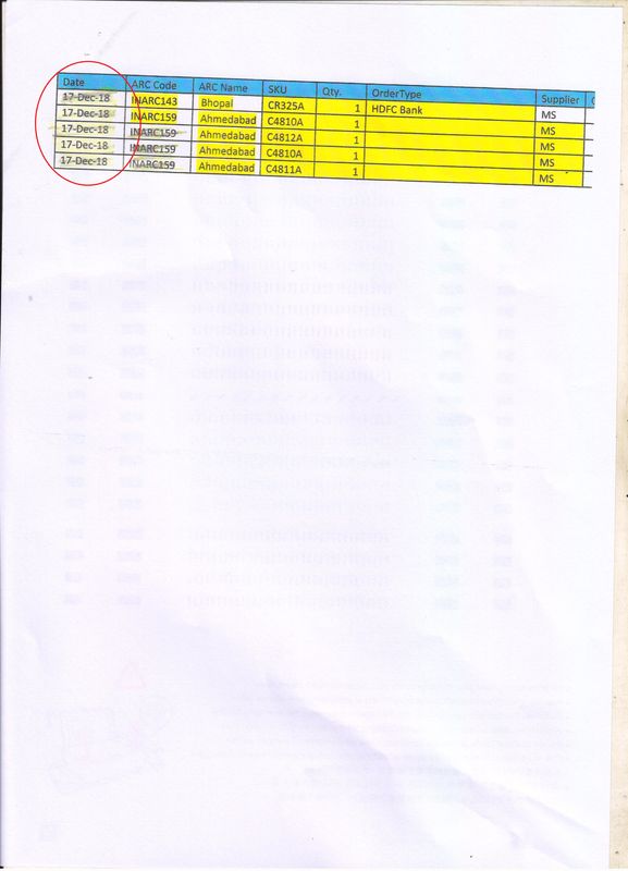

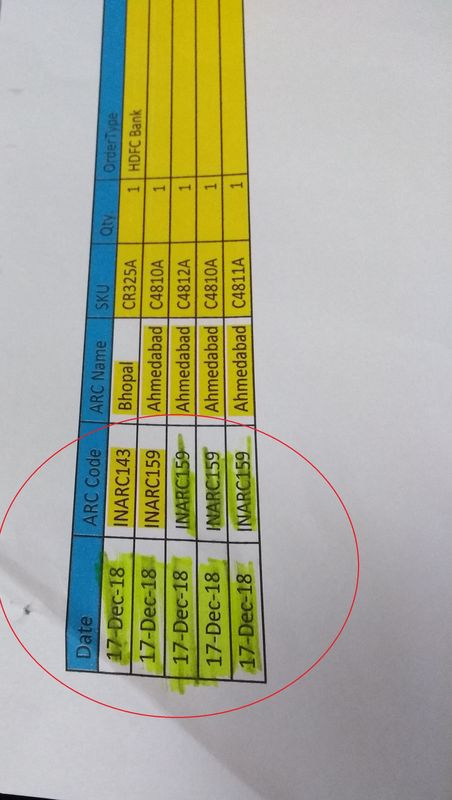

Hi... Thanks for your reply.
I tried all the options as you instructed. I tried scanning in HP Deskjet 2135 and Ink Tank 315.
I tried to take a copy also. But the fluorescent green not apeearing properly...
Below first image taken while scanning, second one taken via camera.
Please find the difference... kindly help

@VIJAYVELU, thanks for prompt quick response and time again.
I appreciate your efforts in sharing the images.
As you mentioned the issue persists while making a copy from the printer.
It certainly looks like a hardware issue with the printer.
I will share you few details through a private message about the service options dedicated to your printer.
Please watch your inbox for more information.
