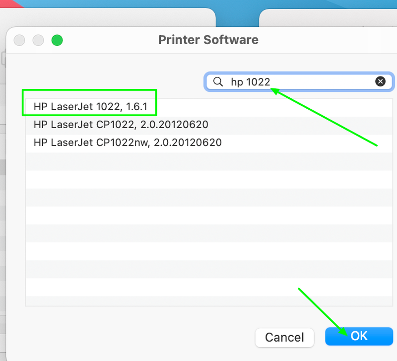

Hi @MandyH1961
Ok, If that doesn´t work, try to Add printer from Printers window and click
the option to Select Software...
and search for quite similar model like "Laserjet 1020" or "Laserjet 1022"
