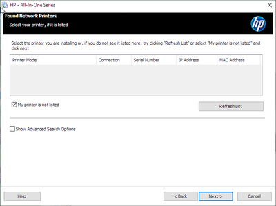

That enabled me to remove the printer driver.  I rebooted the PC and ran the installation program.
As before, when it got to the Found Network printers page, it still does not list my printer, regardless of whether or not I check the box "My printer is not listed".  Clicking on Next only brings me back to the same page.
I have not been able to proceed very far beyond this point.
