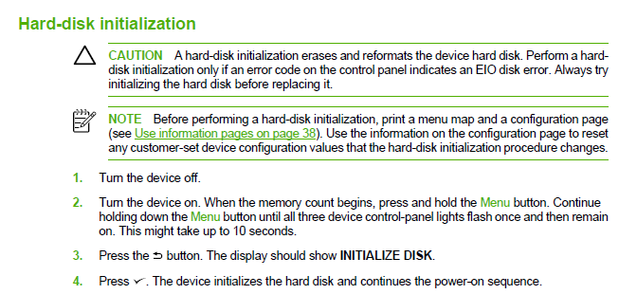

Did you tried disk initialization:
My profile on LinkedIn
Yes, I did, as described in the service manual. No change, startup is still stuck in stage "4/6".
