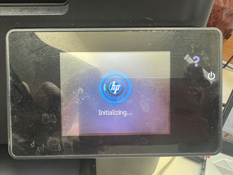

The printer is Laser Jet  Pro MFP M225dw.  It stays stuck in the initializing state.  Unplugging and powering off does not work.  It will do this 15 minute cycle repeatedly for a day or more.

Thanks for the response.  My unit is not the same (even thought the model #'s match.)  When I press the off button, there is nothing left to press as the screen goes dark.  There are no other buttons on mine other than the power.  IMG_3713.jpegIMG_3714.jpegThus, I can not do any of the other steps you list.  Am I screwed or do you have any other ideas.  I can not find a way to get an HP person or chat box.  If you know that, please pass along.
