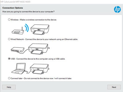

- I removed the printed, can't install it either via wi-fi or usb. Tried... 20+ times.
- I can print from other computers (wi-fi) but not the main one I used

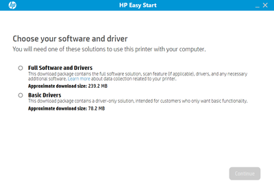

I have tried to install, basic, full, hp smart... no luck.

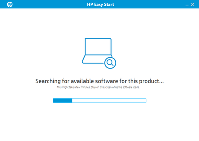

P.S. I have tried one more time, failed - restarted PC, got the message to finish setting up my printer... eventually eneded up seeing the following choice from HP.. took 17 +, I could then select add printer, took another more than 10 min and since then... this is the message I am getting

I have tried all the options, usb, ethernet,wifi...
Every option I try end of 10 min + of the window with installing network device, and each time ending up with unsuccessful installation...
