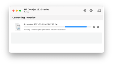

I have installed the latest driver on my MacBook Air (running macOS BigSur), but my HP 2520hc printer doesn't work.
It takes forever to connect to the printer. I have also tried setting it up via the HP smart app but it still doesn't work. Please help!

I am using a USB-C to USB adapter. I've used the adapter and it worked perfectly fine until I got my MacBook formatted.
