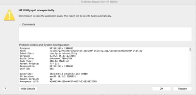

2: I have tended to use the HP Utility to check that I can see the unit. It has always been the most reliable of the suite of applications provided. Now, new with  OS/X 11.2.3 it starts, but any attempt to use any of the functions ("Supplies Levels") tends to cause a crash - this is intermittent but more often than not.

@koborn
Follow the instructions below to remove and reinstall the HP printer software.
  1. Download HP Uninstaller.zip.
  2. Double-click the HP Uninstaller icon.
    HP Uninstaller .zip file icon
  3. Double-click the HP Uninstaller app.
    HP Uninstaller app icon
  4. If a confirmation message opens, click Open.
    Clicking Open in a confirmation message
  5. Follow the in-app instructions to uninstall all the HP software from your system.
  6. If you are prompted for credentials to continue, type the User Name and Password, and then click OK.
    Typing the user name and password and then clicking OK
  7. Once the Uninstaller removes the software, close the HP Uninstaller app.
  8. Go to HP Customer Support - Software and Driver Downloads.
  9. Type your printer model, and then click Submit.
  10. Under Driver or Driver-Product Installation Software, download the latest software for your printer.
    NOTE:
    This might be HP Easy Start, HP Smart, or Mac Printer Driver version 5.1. System administrators and those unable to use HP Easy Start can use HP Easy Admin to download the software pkg files directly for use in managed or remote deployment environments.
  11. Once the download completes, open the software and follow the prompts to complete installation.
  12. For Mac Printer Driver version 5.1, open System Preferences, and then open Printers & Scanners to re-add your printer.
