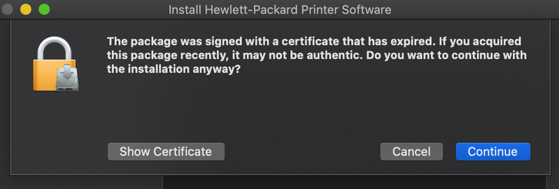

I followed the steps of uninstalling the software using HP Uninstaller on my Deskjet 4500.
After this I tried to let my Mac (Catalina 10.15.7) download and install the printer software but this failed.
So I tried downloading and then installing the software from here:
https://support.hp.com/gb-en/drivers/selfservice/hp-officejet-4500-all-in-one-printer-series-g510/39...
Got this error:
HP please update your certificate so I can carry on using my printer.
Kind regards,
Pierre
