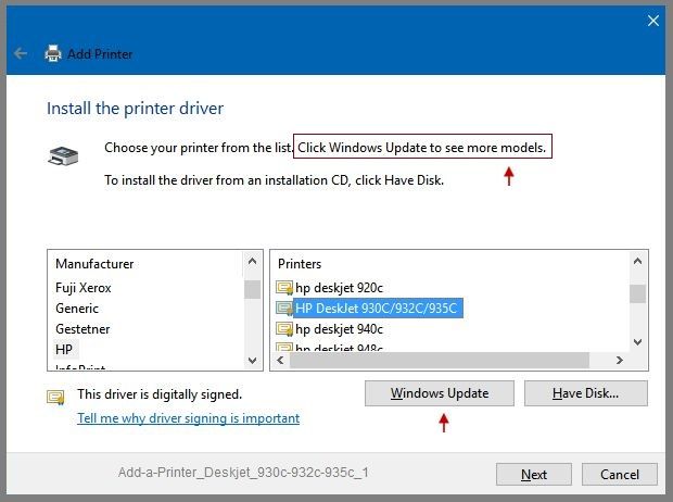

The Add-a-Printer list might need to be "updated" before the 93xC printer group shows up in the list.
Add-a-Printer_Deskjet_930c-932c-935c_1Add-a-Printer_Deskjet_930c-932c-935c_1
Reference

Example – Add a Printer
Reminders:
  • The procedure must be run by an account with Administrator privleges.
  • If using a USB cable to connect the printer to the computer, disconnect the cable before you start the procedure. Connect the cable only when instructed or after the drivers are installed (at the “Finish”).
  • If a “USB port” option is not listed as available, select the LPT port. Connect the cable after the procedure is completed, (and if necessary) Restart the computer and log in
Control Panel > icon view > Devices and Printers > Add a Printer
Click The printer that I want isn’t listed
Click Add a Local or Network Printer…
Click Next
Choose Printer Port menu
  1. Select Use an existing port
  2. Select first LPT port in list or for USB select (if available in list) USB port
OR (if having connection / OS WSD issues)
(Contributed by  ShlomiL – Thread:  Add printer port)
  1. Select Create a new port
  2. Select Drop-down Menu Type of Port
  3. TCP/IP Port > Enter the IP Address, Enter a name for the port
Install the Printer menu
  1. Left column: HP
  2. Right column: Scroll, search, select (click) printer
If Printer is not found in list:
  1. Click Windows Updates
  2. Wait several minutes for list to update
  3. Left column: HP
  4. Right column: Scroll, search, select printer
(Repeat if Necessary)
Click Yes to “…allow this app to make changes to your device” (UAC)
Optional: Type a printer Name or use the default
Next > Wait for printer software to install …
Next >
Click / Select Share this printer so that others on your network can find and use it
OptionalFill in information for printer location and a comment
OptionalClick Set as the default printer
Optional:  Click to Print a test page
Finish

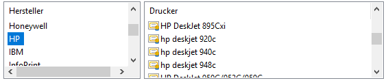

This is rather strange.  when I do the same, deskjet 930c is not part of the list an you can see in the following snippet:
Any idea why  "hp deskjet 930"  is not shown on my Windows 10 ???

I've made some more tries but still cannot make the entry for deskjet 930c visible.
I use the same Windows as you,  Windows 10 Pro,  Vers. 1803 , and the system has been set up in July 2018, so it is very new.
As I can see all the others drivers for deskjet printers like 920c, 940c, 948c, etc. I don't know what can be wrong
on my system to get the correct updated list of printers. See snippet.
