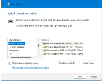

My screen looked like this where I found to take off the printer and added it back as you suggested:
I wonder why it wasn't on the list of LaserJet printers? https://support.hp.com/ca-en/document/ish_4839960-4840167-16
But, I'm happy to report that your solution worked for me! I just printed like always. Thank you for your help. 🙂
