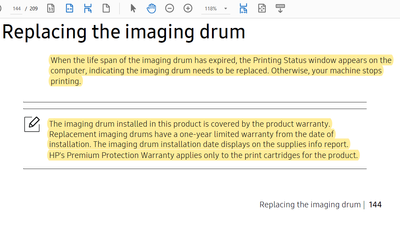

read the User Guide:
The counter is irrelevant here!
