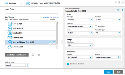

HP Scan software has an additional download for OCR. This is the download support page
https://support.hp.com/us-en/drivers/hp-universal-scan-software/2101620481
Here is the install on my laptop, note the option for editable text

I had installed the Universal print drivers and as Universal Scan Drivers, as well as the HP OCR software.
The option simply does not appear on my Windows 11 desktop using my new OfficeJet Pro 8138e All-in-One..
The marketing people say that this is software works and exist,s but the technical support personnel I spoke with today said that none of the currentHP printers support what you see.  I'll add that you are using a discontinued LaserJet printer and not ancurrent OfficeJet..  My 15 year old OfficeJet 8600, also has this functionality.
Might be a scan software revision change that I have not installed, less likely in my opinion that old or new printer would make a difference. I am on holidays right now so that 575 is the only printer I have ready access to. Still runs exact same firmware as the brand new laserjets so I do not think the printer age is the issue.
