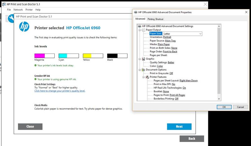

I have had this printer for home use for a handful of weeks, and it has been nothing but trouble.
Each time I want to use it, I pretty much have to uninstall the software and reinstall it to get it to talk to a computer.  What the heck?  If I am using the printer once or twice a week, an uninstall and reinstall shouldn't be necessary EVERY TIME.
Now, it only prints in black and white.  Again, I uninstall and reinstall the software (AGAIN!!!!!!!!!!!!!!!!!!!!!!!!!!!!).  Yes, it is set for color, greyscale is off, it is HP ink installed (we're still on the original cartridges that came with it).  I have cycled the power off, unplugged it, plugged it back in, and turned it on again.  I have removed the ink cartridges and reinstalled them.
If I print a test page, the color sections are missing.
If I scan an pciture on the printer, the viewscreen shows a color image, but it will print black and white.

@cwmette
Welcome to the HP Forums. I would be happy to help you with your HP OfficeJet 6962 Printer. I understand that it is not printing in color and you have already done some preliminary troubleshooting.
Don't worry though as I have a few steps to determine the issue and find a solution as well,
Uninstall the printer software and install the printer with windows built in drivers.
Watch this YouTube video to uninstall the printer software.
You can also refer this document for more steps.
Install the printer with windows builtin driver.
You can refer this YouTube video to install the printer.
For more steps refer this HP Document.
Once you install the printer, change the bellow settings to print in color.
  1. Open Devices and Printers by clicking the Start button , and then, on the Start menu, clicking Devices and Printers.
  2. Right-click the printer that you want to use, and then click Printing preferences.
  3. Make your choices, and then click OK.
  4. Under option Print color select color , then the OK button.
Let me know how it goes.
Cheers.
