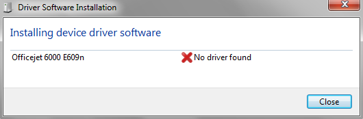

My wireless connection to my Officejet 6000 Wireless printer was lost earlier this week, and seemingly out of nowhere. So, I've spent all week troubleshooting on how to get the connection back. Through much trial and error, I've yet to be able to get my computer to communicate to my printer without an ethernet connection between my router and my printer, which I never had to do before.
In all of this, my USB just stopped recognizing my printer. When I plug it it in, nothing happens. This is a problem, as the process by which you get your wireless connection back requires that you temporarily connect your USB cable  I've downloaded all of the software and drivers for my OS directly from the website, here, and installed and uninstalled multiple times to get them to work. No dice. I've tried using Windows device driver wizard...it says it can't find and thus can't install the driver. And despite being being able to printer from my computer to the router physically connected to the printer, my Device Manager still shows an issue with printer and an "unknown device" that has come out of nowhere:
As you can see, there is nothing shown to be wrong with my USB port, and when I got to update their drivers, it shows them all to be the latest version. BTW, here is what is shown when I run Window's drivers updated for the errors with the printer and "unknown device":

So, the printer is not connecting to my USB port because it looks like whatever has happened while I was trying to fix this blew out the PRINTER'S port. Plugged it into another computer, and that computer didn't recognize it, either. Wow.
