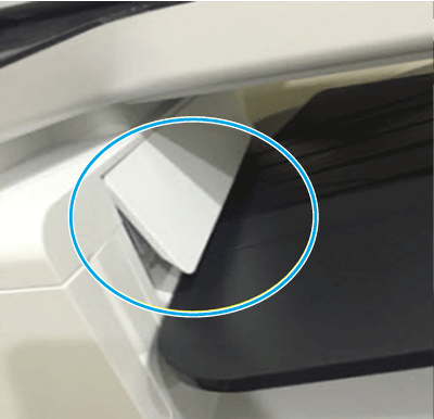

  1. Check the Output Flap:
    • Verify if the output flap is functioning correctly. If the flap is slightly open or doesn't close entirely, inspect it for any obstructions or debris that might be causing the issue.
    • Manually manipulate the flap to ensure it opens and closes properly.
Checking the output flap for obstructions

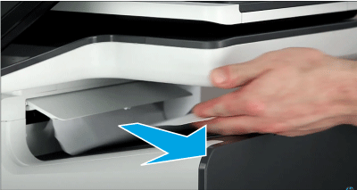

  1. Clear the Output Bin Area:
    • Remove any visible paper or debris from the output bin area, even if it seems empty. Sometimes small bits of paper can cause sensor issues.
Remove paper from the tray
