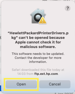

Hi @MarkB417,
From your Downloads folder, right-click the file and select Open rather than double-clicking it, then click on Open:
Screen Shot 2021-10-01 at 14.30.44.pngScreen Shot 2021-10-01 at 14.30.44.png
I do able to successfully install it using this method while testing, then try adding the printer and check for any difference.
Shlomi
Click the Yes button to reply that the response was helpful or to say thanks.
If my post resolve your problem please mark it as an Accepted Solution 🙂
Hi ShlomiL,
I was able to run the package, and it may have helped.  I was able, eventually, to get WiFi printing to work for the LaserJet, but not right away.  Not entirely sure what I did to make it work, but I have reason to believe somewhere in the Mac it had an incorrect IP address for the printer.  The last thing I did before getting it to print was kind of weird: for some reason, the LaserJet was showing up as a network in my WiFi list.  I was able to connect to it and was able to print through that connection. When I reconnected to my regular network, WiFi printing still worked.  No idea, unless the direct connect updated some internal parameter in the Mac with the correct printer IP.  WiFi printing continues to work.
