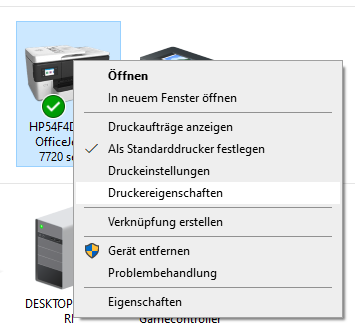

Hi Jay,
Tried it, it brings up I should make the printer the default printer but I can click yes as long as I wish nothing happens.
Even right clicking and trying to set it as default printer doesn't work since the option isn't there. If I skip default selection, it installs the normal software and I end up with no changes. I still see the message that the drivers aren't available but doing the new driver search only ends with best are already installed. 😖
I don't understand why it works on my windows laptop or any of my Android devices but with my main desktop I can only scan but not print.
Ok I don't know how I got finally the option for Printer properties to show up after right clicking but I did and noticed that the connection was set to WSD Port for whatever reason after selecting the TCP one it worked.
