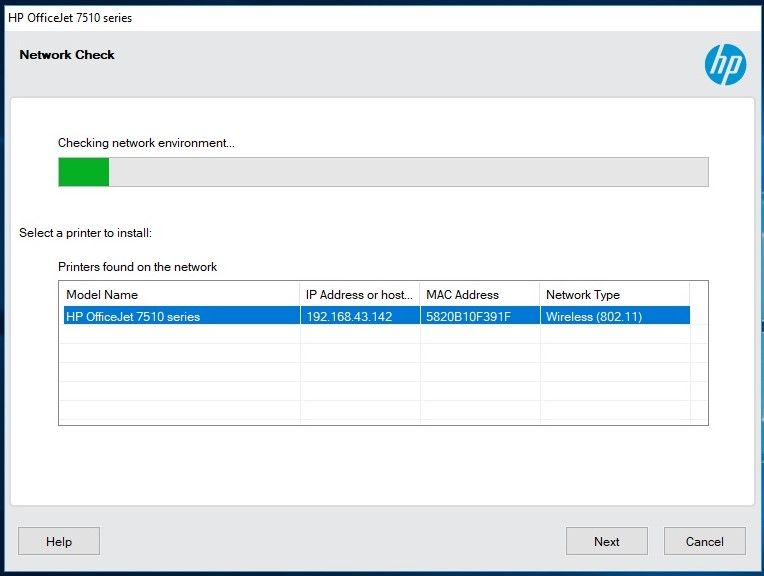

Hello,
My printer was working fine before I made an update to windows 10 (creators update). Each time I try to print Windows tells me that I need to install the driver. When I try to install the driver, it detect the wireless printer but can't connect or intall the driver. I uninstalled the software and reinstalled with compatibility of windows 8 but still the same. I've tried many options but no success such as:
- Turning off the firewall.
- Changing the IP address manually.
- Connecting the printer with USB cable.
Please help me.

Thank you for your reply. Unfortunetly, the steps you sent to me did not work. The printer still cannot be connected. I followed your solution step by step but it did not work. I attached the 2 messages that the installer is showing me every  time.
I have another printer connected wirelessly to my PC (another brand than HP) and its working fine. I forgot to mention last time that I tried the HP doctor and I followed their steps but also no success. Please help.
I was trying many solution from HP website and I downloaded one software "HP Installation Failure - Unknown Device" and again, no success.
I got surprised when I downloaded the HP Smart software from Windows store. It is detecting the printer, showing the ink levels and I can make scan! But I cannot print! It's really confusing me. I hope you can help me.Untitled.jpg
