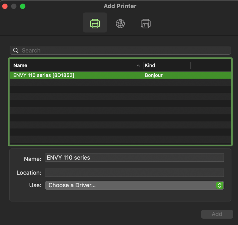

I'm able to print from my iPhone, using the HP Smart app, but have been unable to get my Macbook (Big Sur) to do likewise. HP Smart identifies the Envy 114 (see attached images), but alerts me that I still need to install the printer. I've tried everything I can think of to do so, via WiFi and USB. Continually, Mac OS (printer preferences) is waiting for me to install the correct driver: it doesn't seem to want to use anything generic. Do you have any suggestions as to where to go from here?
Also, I have a Samsung SCX-4500W laser printer that I'm also trying to install, with zero success on either my iPhone or Macbook.
I'm new to this forum and can't tell whether you're an employee or just a very active (and helpful) participant, but I'd like to know if the HP Smart apps are basically designed to replace drivers, especially for older printers like mine (10 years).
Final comment: the HP Smart app on my phone alerts that I need to connect with the HP Setup network in my WiFi, but  it doesn't exist. Any thoughts? Thanks for your help!
Screen Shot 2020-12-18 at 11.15.17 AM.pngScreen Shot 2020-12-17 at 10.04.56 AM.png
Hi @Ortho78,
I’m an expert sharing my knowledge as I can, I’m not an HP Employee.
HP Smart is intended for later printer models and it does not meant to replace the driver for older models as an HP Envy 110 printer.
Please follow HP East Start as listed on my previous post, it should be able to install your printer driver successfully.
Please let me know the results, or the log information if you’re getting any issues during the process.
One completing the install you should be able to print and scanning should be done with HP Easy Scan.

Well the problem seems to have rectified itself, though I'm not exactly sure how, as I thought I'd tried this fix before...
Anyway, I turned off the printer, then deleted it from the Macbook via Preferences. Turned it on again then clicked "add printer" which located the device first time. Then chose "Airprint", and that seems to have worked. For now at any rate......
