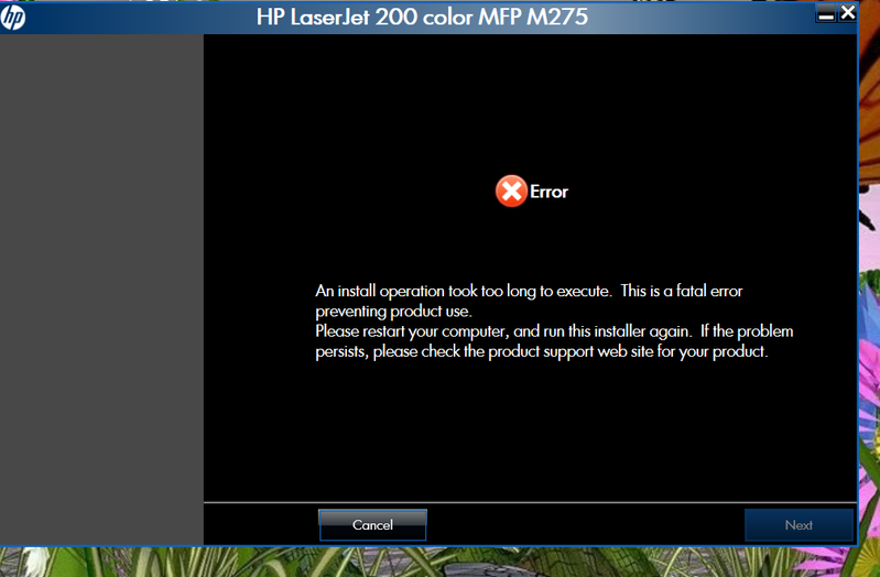

Printer download error.PNGprinter download.PNGT
The above is what I get when I run the Print and Scan Doctor...ran it 3 times and got the same thing????
I will try and help.I think that the driver you are installing is corrupt.Maybe try to install the driver with the 32 bit version if possible will solve the problem.I have not tried this yet but i have heard that in some cases this solved others problem.Hope this will help.
