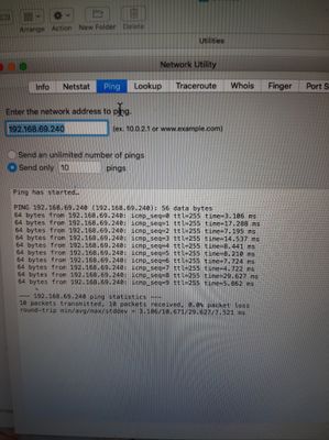

5.) Could you perform a ping test using the Mac Network Utility and let me know the results? Use the printer IP address to perform a ping test, the printer IP can be located by selecting the wireless icon on the printer display.
Perform a ping test to check the connectivity
1.        Obtain the IP address of the printer by clicking on the Wireless icon on the printer
2.        On the MAC Go to Spotlight > search for Network utility > select Ping tab > enter the IP address of the printer in the box
3.        Check the second box that says Send only > 10 pings
4.        Click on ping > Check the results at the end if any packets are lost
5.        Note: There should be 0% packet loss, share the results in your next post.
The wireless status menu on your Mac should also give us quite a lot of information that would help us identify the issue. You can press and hold option-click the WiFi icon and then use shift-command-5 to take the screenshot. Press the space bar when the icon turns into a camera. Share the ping test results and the screenshot with us.

  Thanks for trying to help. I'm still having troubles. It shows the printer and my mac are connected to the same network. But it's still not recognizing the printer. So I have to manually put in the printer IP address again and add the printer.
It says 0 packets received,try the below suggestions to resolve the connectivity issue
