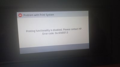

I understand you are getting an error message  on your HP printer. Not to worry I will help you to get a resolution to resolve the issue.
Let's perform a power drain:
  • With the printer turned on, disconnect the power cord from the rear of the printer and also unplug the power cord from the wall outlet.
  • Remove USB cable, if present.
  • Wait for 2-3 minutes, press and hold the power button on your printer for about 30 seconds to remove any additional charge.
  • Now plug back the power cable straight to a wall outlet without any surge protector or an extension cord (This is important) and then plug back the power cord to the printer.
  • Turn on the printer and wait till warm-up period finishes and the printer is idle
Update the printer firmware
Click here to download and install the latest printer firmware from your product
Click here to know different methods of updating printer firmware.
If the issue still persists, I'm sending out a private message to assist you with the next course of action. Please check your Private message icon on the upper right corner of your HP Community profile Next, to your profile Name, you should see a little blue envelope, please click on it or simply click on this link.
