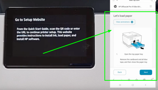

I'm not one for reading the instructions , but I did in this case and noted the comment regarding the ? mark.   However,  my screen does not show a ? mark , even if you scroll down.   It also directs you to a different url.   I have attached a photo for your information. 00000IMG_00000_BURST20250930053405_COVER.jpgIMG_20250930_053428.jpg

Ok, thank you for sharing a photo about the printer screen message.
1. Following the steps in the mentioned URL it shows that the printer needs to Load paper, so just do that,
2. Open the Paper tray and load some paper.

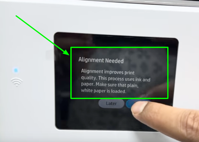

3.  Then check if the Printer screen shows a message about "Alignment needed"
