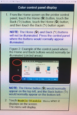

The following should work
To reset the HP PageWide Pro 577dw, you must first enable the Factory Reset from the hidden 'Enable/Disable' menu. To access the hidden 'Enable/Disable' menu, from the home screen, press: Home, Back, Home, Back.
click here for image of the screen
Touch 'Enable/Disable' when it appears at the top of the screen. From here, scroll down to 'Factory Reset' and enable that. After enabling, leave with “go back” and go to Control Panel.

As shown in the photo, after activating it from the hidden enable panel the printer asking for passwordphoto_2024-04-10_14-29-18.jpgphoto_2024-04-10_14-29-15.jpgphoto_2024-04-10_14-29-12.jpg to reset factory
