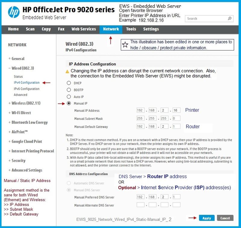

Printer might benefit from having a static / manual IP Address assigned.
Assuming the printer is on the network (Ethernet wired is fine),
You can switch the IP address over to an assigned / static IP address.
The normal "should do" setup applies - for example, if you normally use a DHCP range in your router for certain devices (computers), assign the printer outside of that range.
Expect the connection to the printer to drop when you change the address and click Apply
Wait a minute, then open a new EWS connection to the printer using the "new" IP address.
(Also) Assign / set the printer IP address on the router to reduce possible confusion later.
Example - EWS > Network > Wired (802.3) > IPv4 Configuration > IP Address Configuration
EWS_9025_Network_Wired_IPv4_Static-Manual_IP_2
