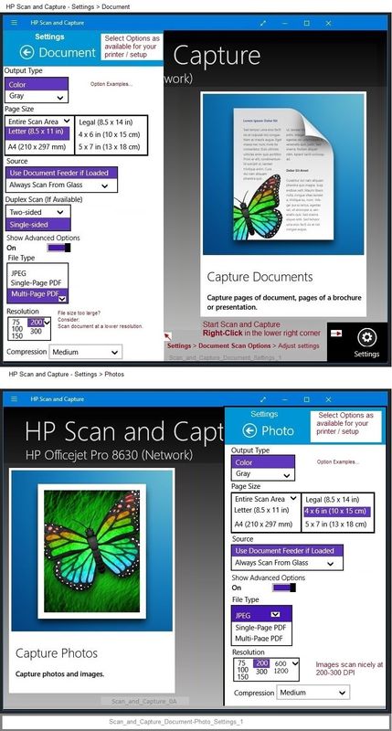

A single page scans OK. but
I cannot get the system to scan multiple pages through the sheet feeder.
The pages feed, but on a single page pdf is produced?

If you WANT single page documents created from multiple sheet scan, HP Smart is not the right tool for the job.
Use HP Scan and separate the job into single documents.

Each scanned sheet is creating a separate PDF file.
You want to scan all pages using the ADF into a single PDF document.
For example,
You are scanning a single sided document of more than one page to create a single PDF file
Answer
In this case you do not need any "add page" tricks -- using HP Smart, the pages will naturally form a single document

Install the Full Feature Software / full driver printer software  (ask if you need help to do that).
Use HP Scan to scan a 2-sided document into a single PDF.

  • Search Windows for your printer model name and number to open HP Printer Assistant. On the Scan tab, click Scan a Document or Photo to open HP Scan.
  • Select Scan Shortcuts > Everyday Scan.
  • In the shortcuts settings, select Document Feeder if loaded in the Source menu, and then select 2-sided (manual) in the Page Sides menu.

HP Scan and Capture
Available from the Microsoft Store (formally Windows Store) - Requires Windows 8 or higher
Download-Save-Install   HP Scan and Capture
 Description
HP Scan and Capture is a simple and fun application that captures photos or documents from any* HP scanning device or your computer's built-in camera.  These images can be previewed, edited, saved, and shared to other applications.
HP Scan and Capture features an adjustable screen size.
* NOTE:  The correct HP print software drivers for your scanner must be installed from HP's Support Website.
Click Start (windows key) > Open the All Apps List > scroll the list
Open Category HP
Find and open the HP Scan and Capture application
Optional
Right-Click on the application and PIN to Start
Application controls / options
Settings > Apps > Apps and Features
Scroll / Search for HP Scan and Capture
Left-click on the App for options associated with this app.
If available, Click Advanced for additional controls.
Scan_and_Capture_Document-Photo_Settings_1Scan_and_Capture_Document-Photo_Settings_1
