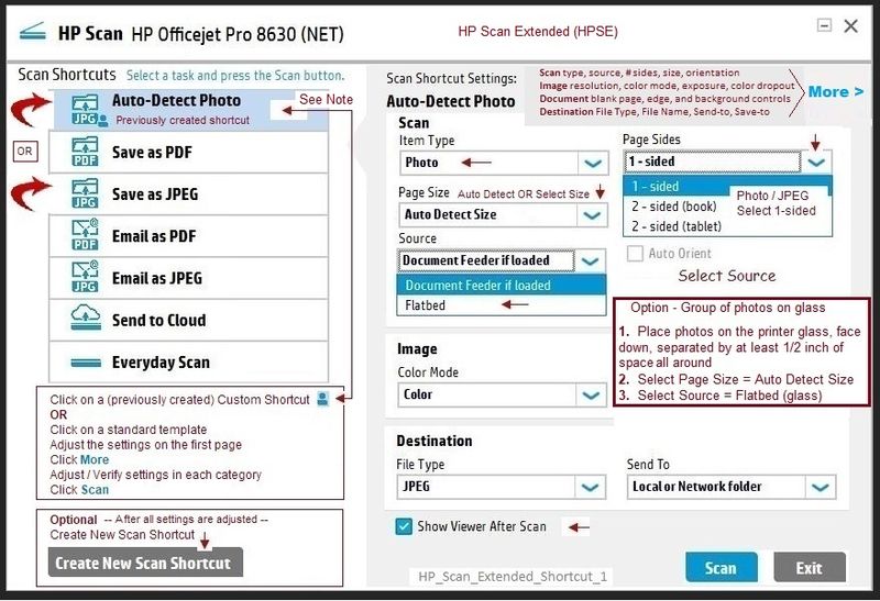

HP Scan Extended
Very similar to HP Scan, HP Scan Extended provides some of the same controls and likely a couple of "extra" features that can be helpful to the scan boundaries.
HP Scan Extended does require that you have (already) installed the Full Feature Software (full driver) for your printer.
General Examples
HP_Scan_Extended_Shortcut_1HP_Scan_Extended_Shortcut_1HPSE_Scan_Examples_1HPSE_Scan_Examples_1
