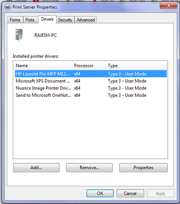

Hi,
Please click the Start dialog and select run, then type the following and press OK:
printui.exe /s
Now open the drivers tab and take a screenshot of tue screen (you may use Snipping tool or press the windows logo + shift + S keys at the same tome and take a screenshot), please attach the picture to your reply (click the Camera icon to add a picture), to better understand any possible cause.
Shlomi

Here you go
Here it is... my printer is accesible but HP scan is not working
