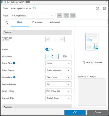

I am unable to print on A5 paper successfully. When I do print, and settings are changed to accommodate A5 paper, once it prints, there is a gap of about 2 inches at the top of the page. How do I fix this, please? Thank you.
Oh, and I am using a MacBook Pro macOS Sequoia Version 15.4.1

  3. Adjust Paper Size:
    • Click on Show Details to expand the print settings window.
    • Select Paper Size and choose A5. Ensure that the paper orientation and margins are set appropriately.

Hi Dragora,
Thank you for your assistance. i realised I hadnt changed the paper size settings on the actual printer. I am used to the printer at work where it automatically selects the paper size. All good and functrioning now!
