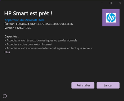

Just to prove to you that the update is the problem,
I uninstalled the new app version and installed the older version of the app.
Voilà!!

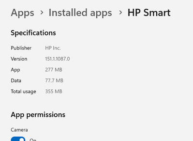

You have windows 11
You had HP Smart 121.2.195.0 and it worked fine.
You went to the Microsoft Store and got the latest French version 151.1.1087.0  which did not work.
Try "reset" by bring up Settings => Apps => Hp Smart

Yep, that's right. repair and reset does nothing getting an older version from the web and installing fixes the problem like I mentioned.
