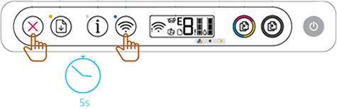

Reset Printer’s Network Settings
If the above steps don’t work, consider resetting the printer’s network settings to default and then trying the setup process again:
  • Use the Cancel and Wireless buttons to restore Wi-Fi setup mode.
  • Press the Cancel button
to ready the printer.
  • Press and hold the Wireless button
and the Cancel button
at the same time for five seconds until the Power button starts blinking.
Note:
  • Your control panel might look different than the following example, but the steps are the same.
Button presses to restore wireless settings
  • Wait until the blue Wireless button light blinks continuously.
  • Within two hours, return to the app or software to find and add your printer and complete the setup.
