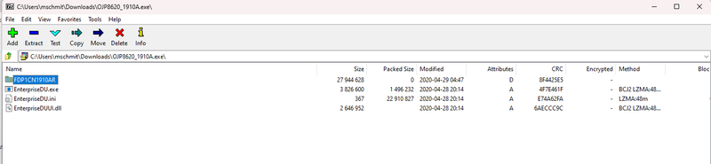

I would try this. Open the firmware update utility file with 7-ZIP
Open the highlighted folder and extract the .ful file to a usb stick formatted to FAT32.
Insert that stick into the usb port on the front of the printer and wait for a USB icon to show up. Touch that icon and you should see several options, one of which should be "upgrade detected". Touch that icon to apply the firmware.
