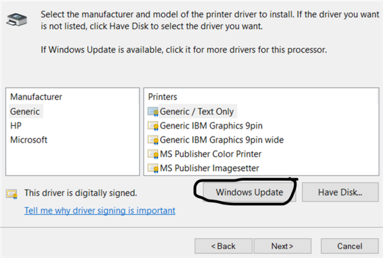

Did you by any chance update Windows 10 to the October update (version 1809)?
I was previously able to print to my Envy 5560, and then suddenly could not. Windows acts like it's printing, sends the job to the print queue, but then it disappears without printing.
The one thing I can think of that has changed since I was last able to print is that I updated to 1809.
I also have a brand new Surface Book 2 (work machine) that never had the printer software intalled on it. I had already updated to 1809 on it. I installed the software today on it, tried to print test pages from within the Windows printer (Manage Printer option) settings, and I get the same behavior as on my other machine, job goes to print queue and then disappears without printing.
I think HP has a problem with the Envy driver on Windows 10 1809.
I used the following workaround to successfully print to my HP ENVY 5660 on Windows 10 1809 on 2 different machines:
Wait a while after clicking Windows Update, it will eventually come back.
Choose the PCL-3 driver for the printer series, and then finsih the installl. You might have to wait a few minutes for it to finish.
When you get back to the printer properties, click OK to apply the PCL-3 driver.
Now try printing a test page from the printer details.
