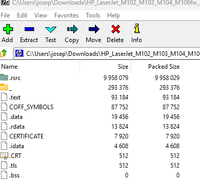

I used 7zip to look at the .exe and did not see a 'bin" file
I would not trust burning a file to rom from the above.
The .rsrc had a large file but its size was not a power of 2 which indicates it is not exactly a rom.
