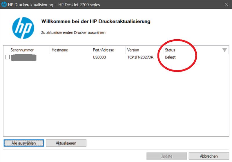

Due to some printer problems I got to update the firmware "TCP1FN23227DR (patch=0)" to the latest "TCP1FN23249DR" of my HP DeskJet 2720e printer.
I tried to do so with the separate downloadable firmware update package via USB connection, as well as WLAN connection. Both ways always fail - see the following screenshots:
status occupied
error at update process
Maybe it has to do with the status "occupied" (I have to translate the german word "Belegt") that is showing in the last "status"-row (i marked it in a red ellipse)?
The error message says (I have to translate) in the right status-row like "error at updating" and the message windows says like: "The update failed on 1 printer. Switch your printer off and on and retry to update." Doing so still fails the update.
What can I do to solve this? Thanks so much for any help in advance!

Dear Irwin6 - thanks for your reply. I am sorry, the images from my first post had been deleted due to personal information. I have cleaned those images now - please have a look:
As you can see, the firmware update fails both ways - via USB as well as WLAN connection. Performing a power drain did not change anything. What can I do now?
