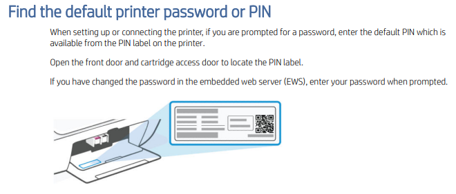

try to set up printer but cannot find password for it
1 REPLY 1
The location of the PIN on an HP printer can vary depending on the model. Here are some common places to look:
  1. On a sticker: Many HP printers have a sticker on the back, bottom, or inside the cartridge access area with the PIN and other default credentials.
  2. On the printer display: If your printer has a display, you can find the PIN under the wireless settings or WPS (Wi-Fi Protected Setup) settings.
  3. If no display: Press the wireless button and the information button at the same time for 3+ seconds to get a printout with the PIN
  4. In the user manual: The PIN is often listed in the printer's user manual or documentation that came with the device
If admin (Admin) and 12345678 or the above PIN do not allow login, then get a network status printout or ask Microsoft's Copilot
For Wi-Fi direct printing there is no username, you just need the printers Wi-Fi password that comes from the network status printout.
