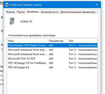

I would urgently request your help with regard to connecting an HP LaserJet 1018 printer to a laptop with the Windows 10 64bit system. The printer is in the Bluetooth and other devices folder and I don't know how to get it be shown in the Printers and scanners folder. The Microsoft word doesn't see the printer so I can't print. It is listed in the device manager as a program device.
First I tried connecting it using HPEasyStart 12.9.8 Before clicking on the exe.file I had connected the printer to the usb port and had a message in the bottom right corner that the installation had been finished.
Nevertheless, I proceeded with the installation process and got to the menu to load the ink and paper and then nothing happened. No buttons to stop installation.
Second I  tried the Windows update but my model is not in the list
I also have a disk with the istallation software but the manual says that it is supposed to be used in the xp version.
I would really appreciate your help
Below are some snapshots:

 Let's try and uninstall the printer software from the root level on your PC and install the full feature printer software.
--->In Windows, search for and open Programs and Features.
--->Select your HP printer.
--->Select Uninstall.
--->In Windows, search for and open Devices and Printers.
--->In the Devices and Printers window look for your HP Printer. If you see it listed, right-click on it and choose "Delete" or "Remove Device.”
--->Open up the run command with the "Windows Key + R" key combo.
--->Type printui.exe /s and click OK.
--->Click on the Drivers tab.
--->Look for HP Printer driver. If you see it click on it and click remove at the bottom.
--->Select OK.
--->Select Apply and OK on the Print Server Properties windows.
--->Close Devices and Printers.
And then reinstall the printer full-featured drivers from the software and drivers page
