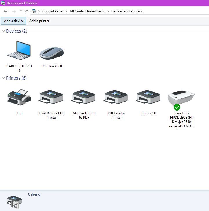

This printer has definitely been more trouble that it's worth.  It finally prints but now It will not function as a scanner when using Corel Paintshop Pro 2019.  I've been working with the support group at Corel and we've tried everything we can think of except maybe turning off Web Services which I don't need anyway.   When I try to use it as a scanner I get the message that the WIA device driver is missing.  I've reinstalled the HP basic drivers and the HP full feature drivers and checked that the WIA in services.msc is running and it is.  I turned it off and back on and rebooted and it still doesn't work.
So I'm here asking for someones help, ideas, suggestions.  I followed the instructions in your article at URL
https://support.hp.com/us-en/product/hp-cloud-services-connected-series/5319203/model/5319204/docume...
however, when I get into the settings after entering the IP address, the tab for Web Services is missing.
So how do I really turn it off?
Here's a screen print showing that the tab is missing.  The additional two screen prints show the Printer is installed and it's full name.
Web Services Tab is MissingWeb Services Tab is Missing
Devices and Printers show Printer 2545 is install.  Not sure why it says Scan OnlyShows Devices and Printers and the HP 2545 Printer installed.JPG
Not sure why this says DO NOT DELETE.  I really don't understand the installation of this printer.

Web Services is probably not available because your printer does not support the feature to connect the printer directly to the Internet.  Web Services might be used for ePrint or Instant Ink subscription, neither of which are applicable to this model printer.

I would guess the "scanner only" message is due to the Full Feature Software not being fully installed.
You might remove and then reinstall the printer software.   Remove, too, the "Basic Drivers" when you remove the other printer software (first section in the procedure below).
